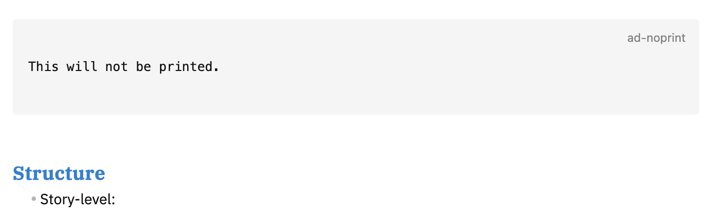

and in my Obsidian note:
```ad-noprint
This will not be printed.
I use the “ad-noprint” because I’m used to doing that for other blocks/formatting. You could probably use whatever custom name you like. Note that I do have the Admonition plugin (9.x) installed.
