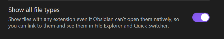

Have you enabled Settings > File and Links > Show all file types?
It’s needed to be able to see those heic files.
