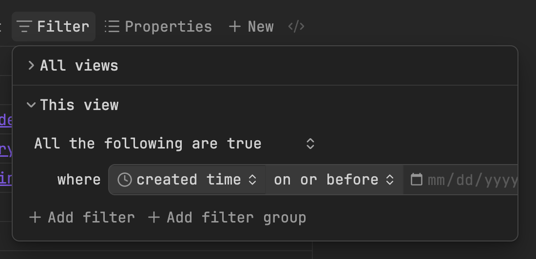

Hi, I have both created and modified fields set up for my notes, but I haven’t figured out how to create a usable filter for them. I’m trying to start with a “created time is on or before” filter, but:
A) I haven’t been able to create advanced filtering that amounts to “created time is on or before today.”
B) I’ve found that if you use longer filter parameters like “on or before,” the filter fields bleed off the edge of the pop-up, which makes it impossible to activate advanced filtering. :man_shrugging:
