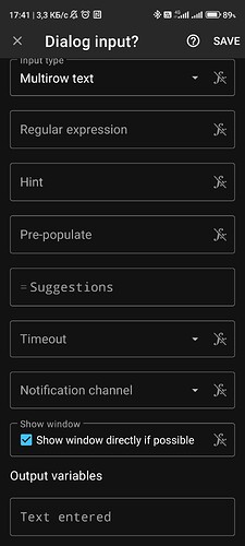

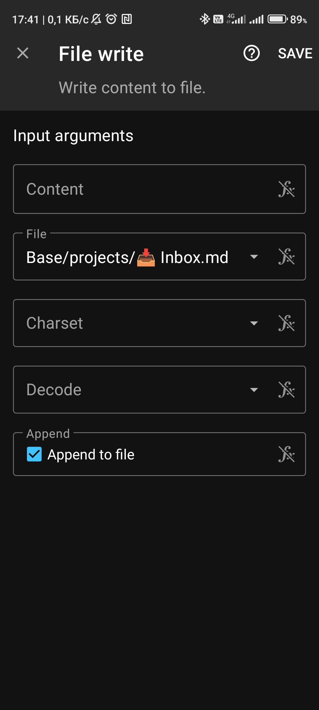

I can’t configure the automation process described on obsidian-gtd/00 Documentation/Mobile quick add.md at main · alangrainger/obsidian-gtd · GitHub. I must be missing something. I can enter text in the “add task” window, but this text is not saved to the note. Here are my screenshots

@Absolut108 I can see from your screenshot you don’t have anything in the Content field on the final screen, so that’s why there’s no content.
You need to add the variable from where you store the value on the previous screen.
Here’s the export of my template which might help: Quick add task to Obsidian - Automate for Android.flo
