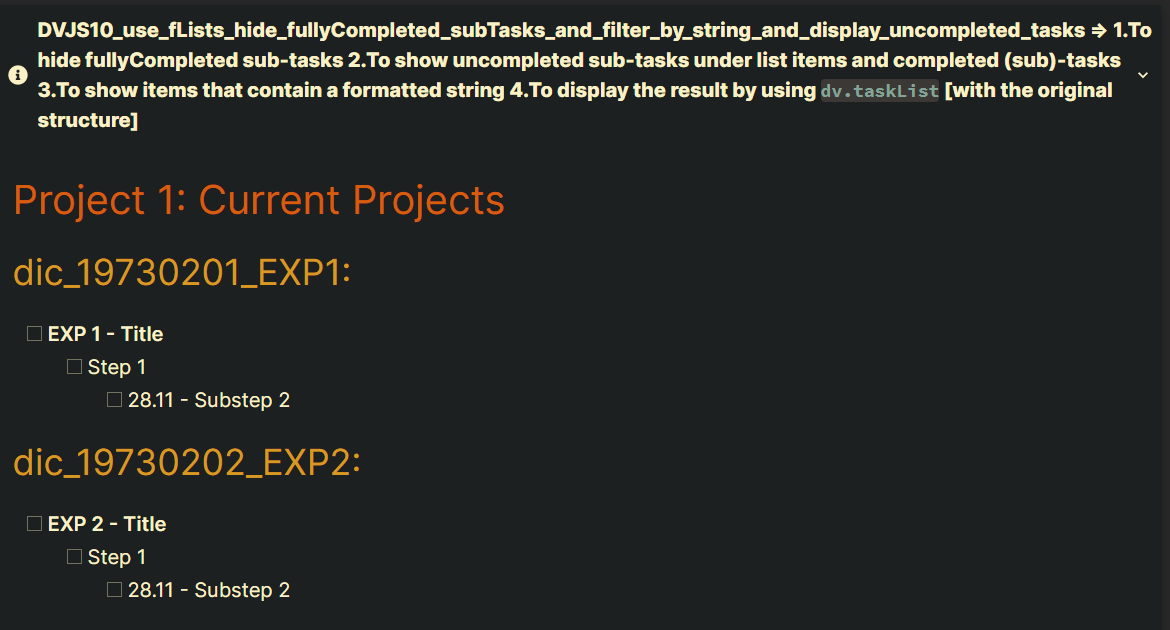

EXP 1 - Title
  • [ ] (dt:: 2022-11-28) - Substep 2
Final question: How can I show "Step1 above “Substep 2”?

DVJS10_use_fLists_hide_fullyCompleted_subTasks_and_filter_by_string_and_display_uncompleted_tasks: For CASE S4 or S6 ONLY
Summary
Main DVJS
Code Name Data type Group By Purposes Remark
DVJS10
_use_fLists
_hide
_and
_filter_by_string
_and
file.lists:
a list item or
a task item
with a formatted string like "dd.MM - "
yes 1.To hide fullyCompleted sub-tasks
2.To show uncompleted sub-tasks under list items and completed (sub)-tasks
3.To show items that contain a formatted string
4.To display the result by using dv.taskList [with the original structure]

```dataviewjs
// M01. define MAIN_TITLE:
const MAIN_TITLE = "Project 1: Current Projects";
// M03. define STRING_TO_SEARCH_FOR:
// const STRING_TO_SEARCH_FOR = "29.11 -"; // "dd.MM -"
const STRING_TO_SEARCH_FOR = "28.11 -"; // "dd.MM -"

Screenshots(DVJS10)
const STRING_TO_SEARCH_FOR = “28.11 -”;
