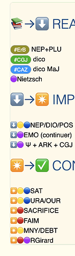

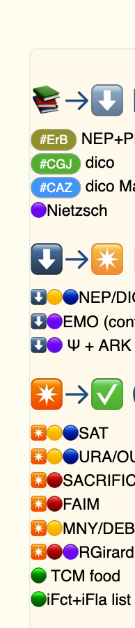

i suddenly had an emoji rendering changing in obsidian.
it was normal for months and for no reasons the emoji turned darker.
i am on macos Tahoe .2 + last obsidian version.
i jsut figured out that when i remove a CSS line, the emoji come back to normal color :
:root div:has(:is(h1,h2,h3,h4,h5,h6))+div>p {
margin-top: 0px;}
to be more precised, when i remove the “p” after DIV, it comes back to normal.
i added that line to remove the space of the paragraph
anyone has an idea on whats going on???

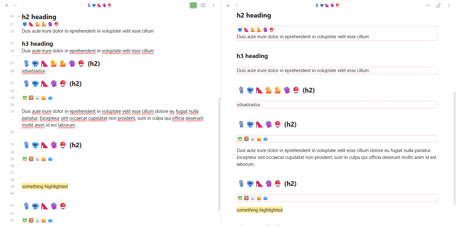

Using
.markdown-rendered div:has(:is(h1,h2,h3,h4,h5,h6)) + div > p {
    margin-top: 25px;
    border: 1px dotted salmon;
(starting with :root is the same) I see no color changes using Windows 11, Obsidian 1.11.4, 1.10.6 installer.
live preview | reading view
I can check on macOS later.
Is there anything else in your .css file? If you switch to the default theme and disable other CSS snippets, do your see the same? Using only that snippet and the same content in a new vault, what does it look like? I’d try doing that to see if you can suss out the cause.

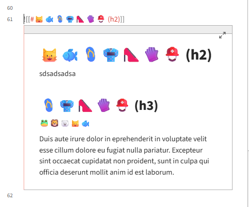

Embed (using Prism) with no snippet:

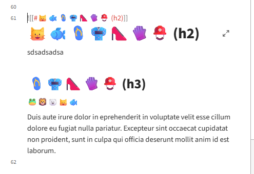

Embed (using Prism) with snippet:
