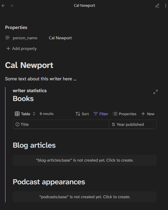

I’m aware of that possibility, but I’d like to create a section as an embedded file, so we’ll need to go a level deeper.
The problem is that an embedded file seems to be completely agnostic of the embedding file. Embedding a .base file into your writer/person file works because the writer file parses the base as if it were part of the writer file itself (like using the code block form of bases), not because the base file “knows” anything about the writer file. So the solution by Craig above works for if you filter by writer == this.person_name in my example below, but it won’t work for nested embeds, i.e. a base that is more than one level “below” the writer file.

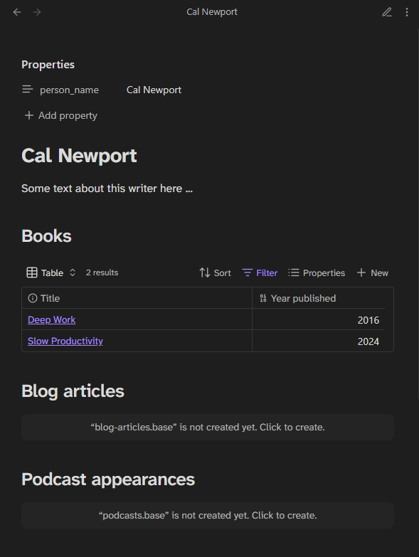

Cal Newport.md
person_name: Cal Newport
# Cal Newport
Some text about this writer here ...
![[writer statistics]]
writer statistics.md
## Books
![[books.base]]
## Blog articles
![[blog-articles.base]]
## Podcast appearances
![[podcasts.base]]

This won’t work because writer statistics.md has no person_name property.
If we directly include the content from writer statistics.md in the writer’s file, however, it works.

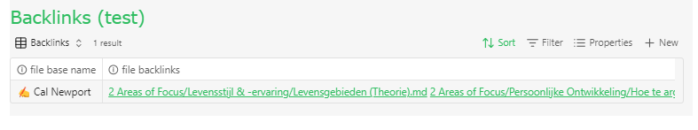

The information is available, but it’s a matter of showing it the right way. When I use your setup, I can get this to work (“creator_statistics.md” as an embedded file inside “Cal Newport.md”. A Base called backlinks embedded inside “creator_statistics.md”).
It’s now just a matter of getting file.backlinks as a list in the first column…
