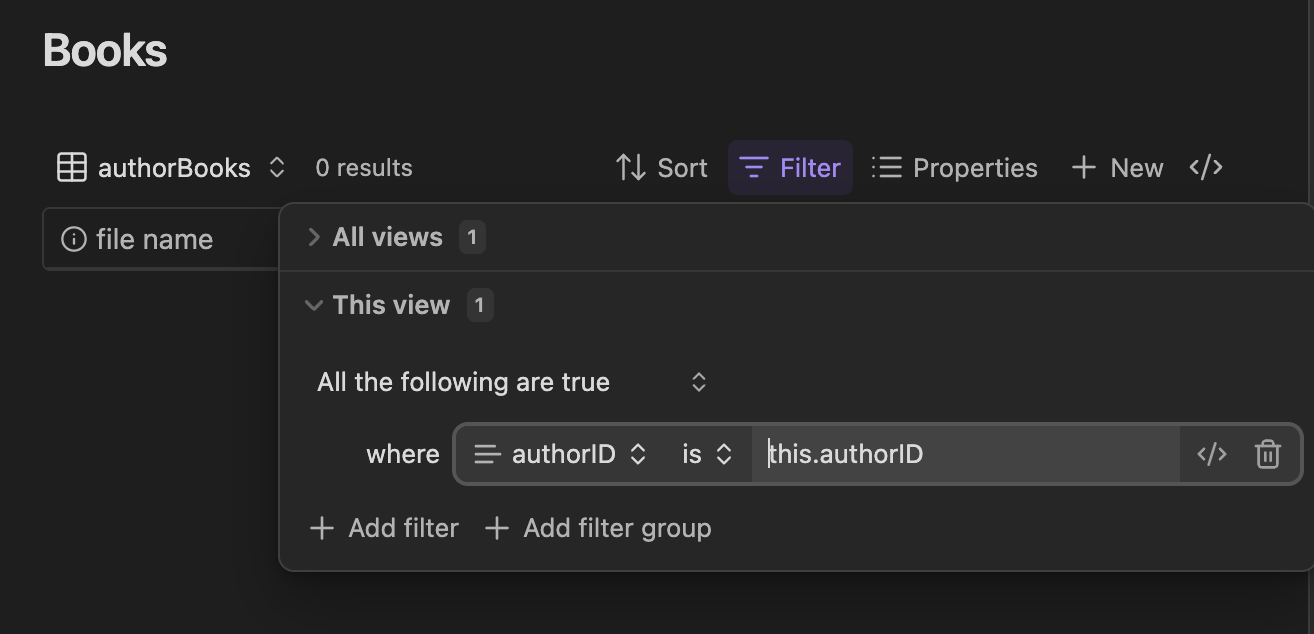

If I set the view to: All the following are true
where authorID is this.authorID
I get zero books

This does work if you write in the advanced mode
authorID == this.authorID
It does not work, if you use the editor:
Yeah, this (AFAIK) can only be used in the advanced filter mode :blush: … and I think it was always like this.
