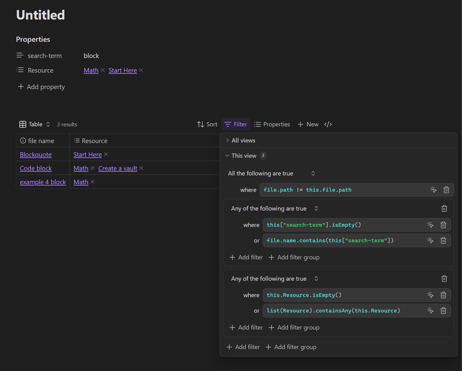

That error sounds like some of your Resource values are formatted as text instead of list.
Try this filter instead:
list(Resource).containsAny(this.Resource)
If that stops the error, then you can keep it (quick method) or clean up the format in your notes (probably a better idea to forestall other issues).
Separately, note that if you want search-term to be a text property like in your example, then
file.name.contains(this["search-term"])
… is sufficient. You don’t need containsAny there. That didn’t cause the error, Resources probably caused it, but just FYI.
But if you want search-term to be be a list, then you can use:
this["search-term"].filter(file.name.contains(value))
Grouping your filters with checks for empty values would take care of the if statement you mentioned:
```base
views:
  - type: table
    filters:
      and:
        - file.path != this.file.path
        - or:
            - this["search-term"].isEmpty()
            - file.name.contains(this["search-term"])
        - or:
            - this.Resource.isEmpty()
            - list(Resource).containsAny(this.Resource)
    order:
      - file.name
      - Resource
