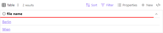

Draw a thick line below the header of a bases’ result table.
I created the following css-snippet.
.bases-table-header {
    border-bottom: solid 3px #ff4040;
As one can see, the thick line does not expand over the whole width of the column.

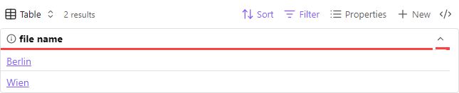

So I tried the following:
.bases-table-header,
.bases-table-header-sort,
.bases-table-header-resizer {
If you look very closely, you can see that .bases-table-header-resizer works fine (the short line at the far right position), but the line defined by css class .bases-table-header-sort is slightly misplaced to the top and to the right.
I did some experiments in developer console with disabling css properties and the like, but didn’t find a solution. Can anyone give me a hint?
You could give this a try:
.bases-table-header-sort {
    top: 0px;
    padding-inline-start: 4px;
It doesn’t seem to break anything. :sweat_smile:
Obsidian_rMADDyFWLf
I know I’m at war with the CSS box model.
Thank you very much, also in my vault your solution works perfect!
Meanwhile I found a simpler solution :wink:
.bases-thead .bases-tr {
	border-bottom: solid 3px #ff0000;
With this snippet the thick line expands over the whole width of the table, even if the last column does not (to solve this problem, I came up with this idea.).
