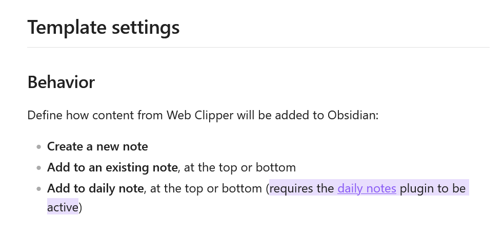

Oh no, I’m so sorry for not asking sooner about append. I wasn’t aware until checking the docs one last time, seconds before I was about say you had given enough info to reliably reproduce your bug.
Alas
You were right all along. Enabling daily notes simply is a requirement for using “Add to daily note”.
