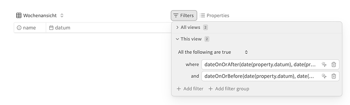

dateOnOrAfter and dateOnOrBefore not working together in Base filters
I’m working with a Base that filters notes using date properties. This works:
dateOnOrAfter(date(property.datum), date(property.wstart))
And this also works:
dateOnOrBefore(date(property.datum), date(property.wende))
But combining both:
  • dateOnOrAfter(date(property.datum), date(property.wstart))
  • dateOnOrBefore(date(property.datum), date(property.wende))
    returns no results — even though the data clearly matches the conditions.
All properties (datum, wstart, wende) are set and correctly formatted as YYYY-MM-DD.
Is this a known issue with date comparisons in Bases? Could this be a bug or an issue with type coercion?
I’d appreciate any insights or workarounds!

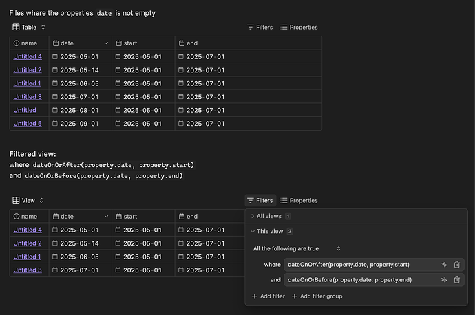

Are you trying to trying to filter an embedded base/view ? :blush:
Are the start date and end date all the same ?
(if not, you’ll be comparing a date to multiple various ranges)
I tried to replicate your setup, based on your description … but it seems to work as expected for me :woman_shrugging:
(I didn’t use date() though, as the keys I used are date type of keys :blush:)

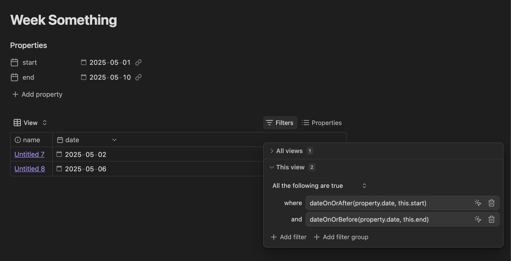

I am trying to create a week view where only the week note has the start and end dates. The filtered files just have a date.
Ah :blush:
Then you’ll probably need to rely on self-referential properties so that would be this.wstart and this.wende :blush:
The filter of the view here is:
where dateOnOrAfter(property.date, this.start)
and dateOnOrBefore(property.date, this.end)
Perfect :star_struck:
Thank you!
