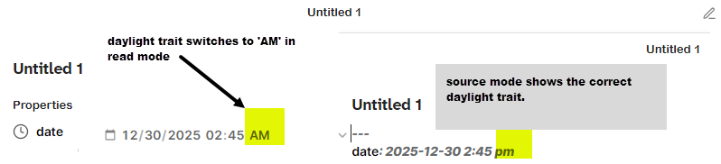

"Visual proof attached: Screenshot shows source mode with correct 'pm' designation vs reading mode Properties panel displaying incorrect 'AM'. This bug also affects all existing notes created before v1.10.6 - notes that were displaying correctly before the update now exhibit this PM→AM conversion error."

I appreciate the quick response, however the explanation doesn’t align with the evidence provided.
The screenshot clearly shows: date: 2025-12-30 2:45 pm in source mode frontmatter. This is neither ISO 8601 format nor 24-hour time - it’s plain text “pm” visible in the raw markdown, which contradicts the statement that “there’s no am and pm in source mode.”

The bug may have been transient, but the screenshot evidence shows it was real and affected existing notes created before v1.10.6. If others experience this, the workaround is to use ISO 8601 format (YYYY-MM-DDTHH:mm) in templates/plugins.
