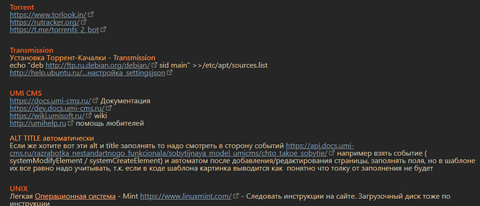

URLs list:
Make a list of all the URLs in the Vault as:
Note name
Header
URL
let searchTerm = /(https?:\/\/)/i;  // Could be any word or REGexp like "http" or "cool"
dv.paragraph("# Lines containing 'http' or 'https:");
dv.pages().file.forEach(file => {
    let filePath = file.path;
    let note = app.vault.getAbstractFileByPath(filePath);
    // Read the content of the note
    app.vault.cachedRead(note).then(content => {
        let lines = content.split("\n");
        let currentHeader = null;
        let output = [];
        // Process lines
        lines.forEach(line => {
            line = line.trim(); // Trim whitespace
            if (line.startsWith("#")) {
                //currentHeader = line; // Update current header
                currentHeader = line.replace(/^#+\s*/, '');
            } else if (searchTerm.test(line)) { // Use .test() to check for matches
                if (!output.length) {
                    output.push(`**${file.name}**`); // Add note name only once
                if (currentHeader) {
                    output.push(`\t<span style="color: #FFA347;">${currentHeader}</span>`); // Add header
                    currentHeader = null; // Avoid duplicate headers
                output.push(`\t\t${line}`); // Add line with link
        // Display the output if links were found
        if (output.length > 0) {
            dv.paragraph(output.join("\n"));

Here’s my take on an outline from headings across multiple files… If pages have “intro” content in them, that will be displayed before the outline for each file. The outline itself is rebuilt as a multi-level list with some extra line breaks to aid with visual separation.
for (let page of dv.pages('"Course/The Gospel"').sort(p => p.file.name, 'asc')) {
    // display the page name as main header
    dv.header(1, page.file.name);
    const content = await dv.io.load(page.file.path);
    const lines = content.split(/\r?\n/);
    // each page contains an "intro" section and some headings
    var intro = [];
    var outline = [];
    for (let line of lines) {
        const match = line.match(/^(#+)\s+(.*)/);
        // this line contains a heading; add to the outline
        if (match) {
            const head = match[1];
            const text = match[2];
            const indent = "  ".repeat(head.length - 1);
            const link = dv.sectionLink(page.file.path, text, false, text)
            outline.push(indent + '- ' + link + '<br><br>');
		// if there is no outline, we are still in the "intro" section
        } else if (outline.length == 0) {
            intro.push(line);
    dv.paragraph(intro.join('\n'));
    dv.paragraph('---')
    dv.paragraph(outline.join('\n'));

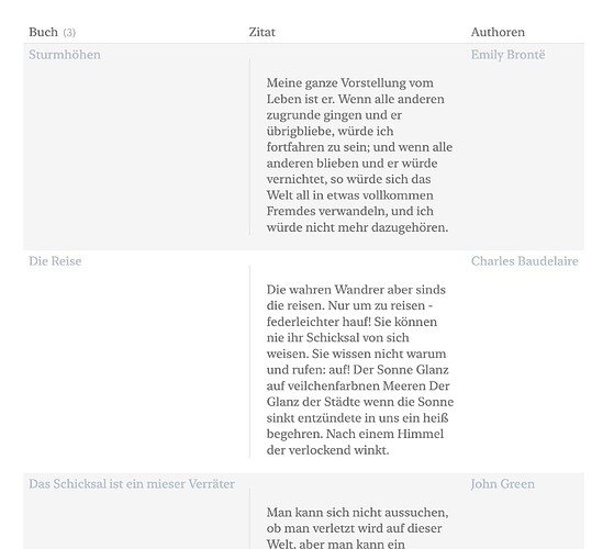

Hi. Thank you for the code. It kind of worked for me. I´m trying to generate a quotes DB. As I said, the query is working but the output is a little bit off. Is it possible to remove the vertical line? Thank you.

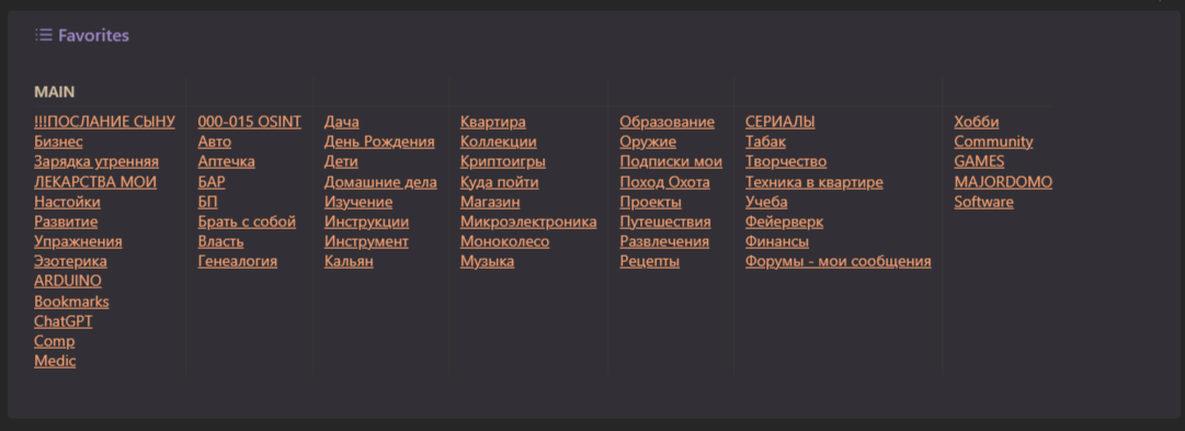

My Dashboard - Homepage. Its a section for favorite notes:
Mark Note with [[Dashboard]] for favorites and [[DashboardFAV]] for Most important Notes.
Script will put Important notes to the first column and then all marked Notes one by one approx equally column by column. You can choose column quantity and Mode - each note link in cell or All note links in Column. Just try.
You can change Callout at the end of the code as per MD
// Флаг для выбора режима вывода
const useSingleCell = true; // true для режима <br>, false для режима "по ячейкам"
const columns = 6; // Количество колонок для Dashboard (всего колонок будет columns + 1, первая — для FAV)
// Получаем все заметки, которые ссылаются на [[DashboardFAV]]
const favPages = dv.pages('[[DashboardFAV]]')
    .sort(p => p.file.name) // Сортируем по алфавиту
    .map(p => `[[${p.file.name}]]`); // Преобразуем в массив ссылок
// Получаем все заметки, которые ссылаются на [[Dashboard]]
const dashPages = dv.pages('[[Dashboard]]')
// Вычисляем количество строк
const rows = Math.ceil(dashPages.length / columns);
// Группируем элементы из dashPages по колонкам
let columnData = Array.from({ length: columns }, () => []);
for (let i = 0; i < dashPages.length; i++) {
    const colIndex = Math.floor(i / rows); // Определяем индекс колонки
    columnData[colIndex].push(dashPages[i]);
// Создаем заголовки таблицы
let table = "| MAIN |"; // Начинаем с заголовка для FAV
for (let j = 0; j < columns; j++) {
    table += `  |`; // Добавляем заголовки для остальных колонок
table += "\n";
// Добавляем разделитель для заголовков
table += "| --- |";
    table += ` --- |`;
table += "\n";
if (useSingleCell) {
    // Режим: Все ссылки в одной ячейке через <br>
    table += `| ${favPages.join("<br>")} |`; // Все FAV в одной ячейке через <br>
    for (let col of columnData) {
        table += ` ${col.join("<br>")} |`; // Все элементы колонки в одной ячейке через <br>
    table += "\n";
} else {
    // Режим: Каждая ссылка в отдельной ячейке
    for (let i = 0; i < rows; i++) {
        let row = `| ${favPages[i] || ""} |`; // Добавляем элемент из favPages или оставляем пустым
            row += ` ${columnData[j][i] || ""} |`; // Добавляем элементы из соответствующей колонки
        table += row + "\n"; // Добавляем строку к таблице
// Обертываем результат в callout
const result = `> [!example] Favorites\n> ${table}`;
// Выводим результат
dv.paragraph(result);
