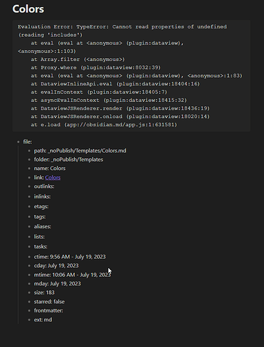

Where are you Metadata defined? In the frontmatter, or in the body? Have you seen it in the output from:
`= dv.span(dv.current())`
The metadata is at frontmatter:

dv.table(["Contain Blue: ",""], dv.pages()
  .where(f => f.colors.includes("Blue"))
  .sort( s => s.file.link)
  .map((m) => [m.file.link]) )
You’ve got multiple issues in that code segment which needs to be addressed:
  • first and foremost you need to verify that colors exist before trying to read its value. Remember that dv.pages() initially starts out with every page of your vault. So you need to change the where clause to something like f.colors && f.colors.includes("Blue")
  • colors is also an array of links, so it might not work doing a simple includes()
  • it might also not work to check for “Blue” when your value is “blue”
I don’t have time to write it out fully, but hopefully this should get you (or someone else with better time) going to get your issue solved.
