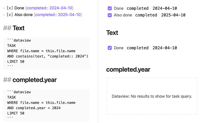

I must be doing something wrong as I can’t get completed.year = 2024 to return any tasks.
- [x] Done [completed:: 2024-04-10]
- [x] Also done [completed:: 2025-04-10]
## Text
```dataview
TASK
WHERE file.name = this.file.name
AND contains(text, "completed:: 2024")
LIMIT 50
## completed.year
```dataview
TASK
AND completed.year = 2024
LIMIT 50
Hehe, the devil is in the details—by accident! I saw this. The word should be completion instead of completed. Then @holroy’s solution works. At least by this: Metadata on Tasks and Lists - Dataview. completed is boolean.
