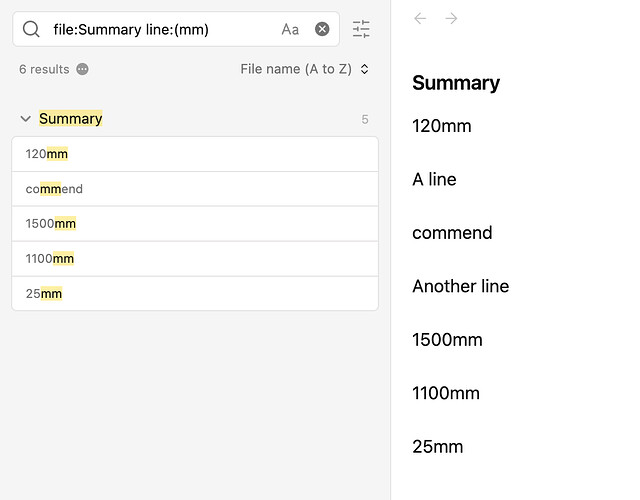

A regular search / query can pull data from files and then lines. Would that work for you?
In the example below, the query is looking in a file called Summary for lines that contain mm.
file:Summary line:(mm)
