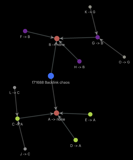

Here is an attempt at a visual representation of your example:

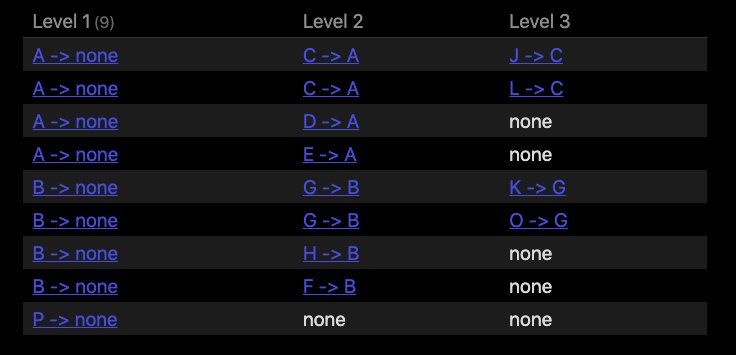

And it could produce output like the following:

Basically this scripts loops through all the inlinks to the start file and for each of them it goes recursively down one level and repeats the same for all inlinks to that file. If none are found, it returns none for all those levels. The way to read this table is that a link in the table links to the page in its left column.
So for the first row we can deduce that “J → C” has a link to “C → A” which has a link to “A → none” which doesn’t link to anything besides the current file. Sorry for confusing names, but I needed to have something to help me keep track of which note linked where… :slight_smile:
