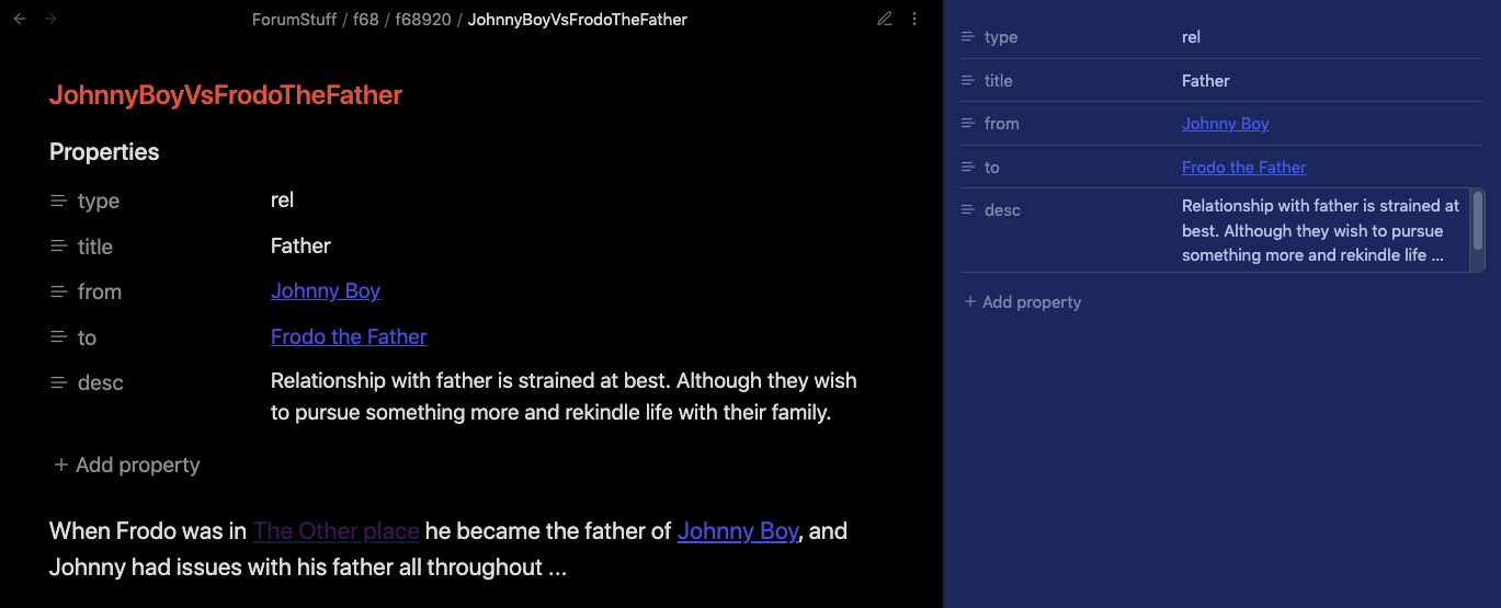

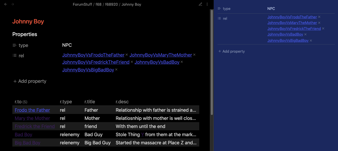

  • Using dedicated notes to describe the relations. This looks the best in the properties view (IMO), and allows for editing of the various details in their respective notes. The dedicated notes also allow for extended information related to how the relation occurred, or has evolved and so on, which might be worthwhile. This is also the only format which easily allows for links between the various NPC’s and relations and so on
Here is an image of the Johnny Boy (the main character):
And here is an image of the relation to the father:
Note that there are various queries also included in the test files, which hopefully can get you going related to how to query these kind of structures.
