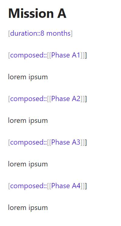

I have two type of note: Mission and Phase. I use composed:: to link Mission to Phase, I have several Phase for one Mission. On both notes, there is the duration property.
So I am looking for a way to check if the sum of the duration of Phases (related to a specific Mission) is less than the duration of the Mission that are linked to Phase through composed::

So if all of your duration values use the recognized duration format, such as [duration::2.5 days], and each of your composed properties contains one link to one phase note, such as:

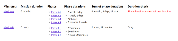

… then you could get a summary and duration check like this:
… by using this Dataview query:
```dataview
TABLE WITHOUT ID
	file.link AS "Mission",
	duration AS "Mission duration",
	composed AS "Phases",
	composed.duration AS "Phase durations",
	sum(composed.duration) AS "Sum of phase durations",
	choice(duration >= sum(composed.duration), "Okay", "<span style='color: red'>Phase durations exceed mission duration</span>") AS "Duration check"
WHERE composed

Thank you so much!!! I didn’t yet understood how that works, but that works as excepted. I will analyse carefully. Thank you again.
