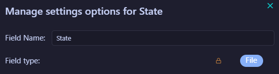

Also Guapas code does not filter the state containing “6”
I think, my problem is, that the Property is shown als Text but the Entry is a link/file
it coming from a “metadata menu” class.
the solution ist
WHERE state != link("6 Done")

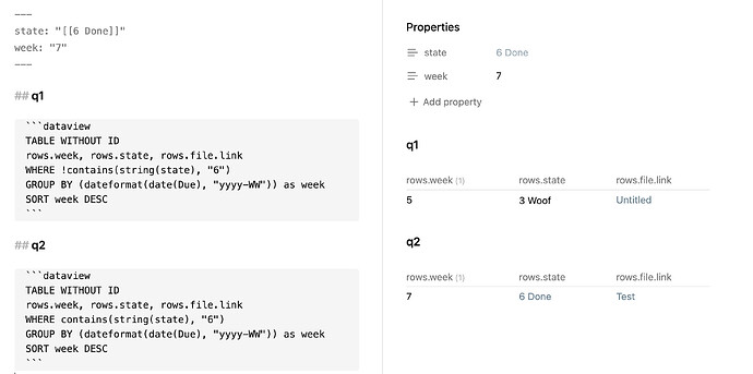

Cool. Makes a difference being a link. Should also be able to get part of the link with:
state: "[[6 Done]]"
week: "7"
## q1
```dataview
TABLE WITHOUT ID
rows.week, rows.state, rows.file.link
WHERE !contains(string(state), "6")
GROUP BY (dateformat(date(Due), "yyyy-WW")) as week
SORT week DESC
## q2
```dataview
TABLE WITHOUT ID
WHERE contains(string(state), "6")
SORT week DESC
