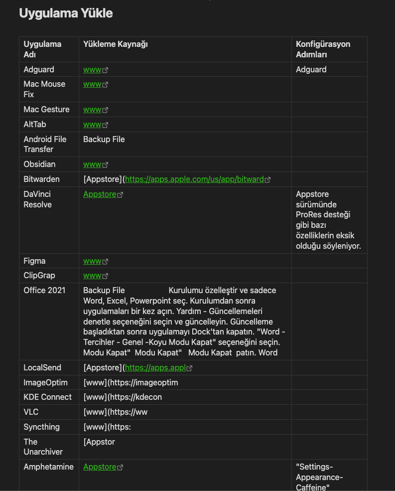

Data loss for using tables
  1. Create a table.
  2. Fill table a lot of words.
  3. Change view to read mode.
  4. Table messed up.
  5. Some information lost on the table. (I was able to recover file from recovery plugin.)
Y
The tables should have been displayed correctly.
Table messed up. This issue sometimes happened.
Obsidian version: 1.12.7
Installer version: 1.12.7
Operating system: Darwin Kernel Version 25.4.0: Thu Mar 19 19:32:36 PDT 2026; root:xnu-12377.101.15~1/RELEASE_ARM64_T8103 25.4.0
Language: tr
Snippets enabled: 1
Plugins installed: 1
Plugins enabled: 0

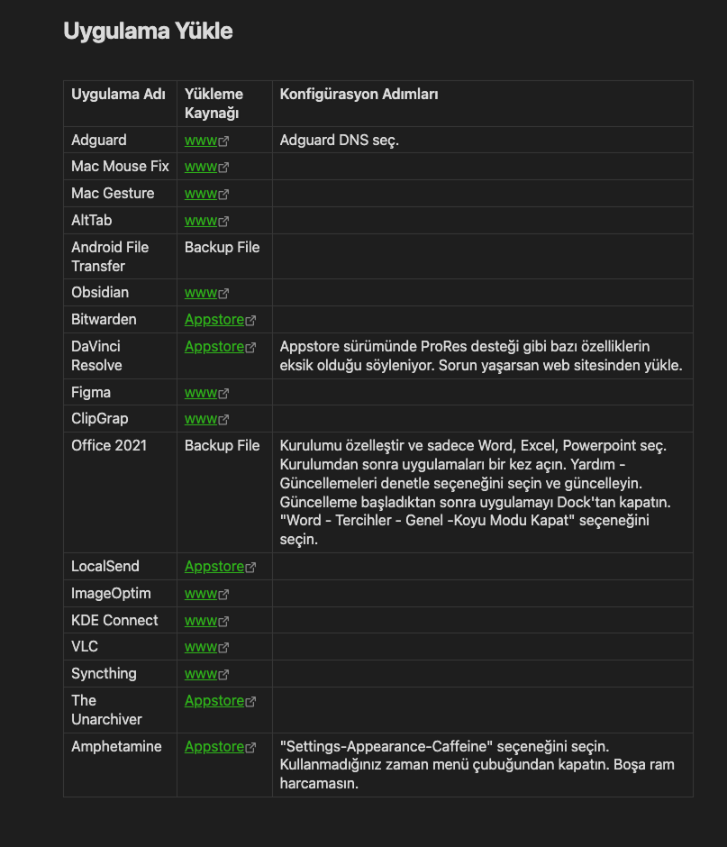

I found the cause of the problem. This css snippet is the problem. I had artificial intelligence write this code for me. I deleted it. Problem solved. Thank you.
