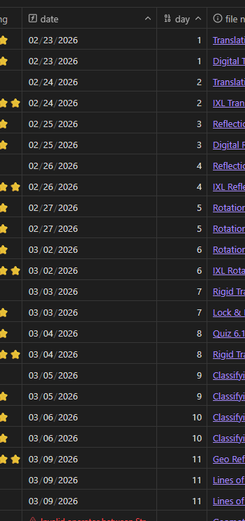

Here is the result. Notice that the date skips 2 days every 5 days:
