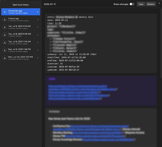

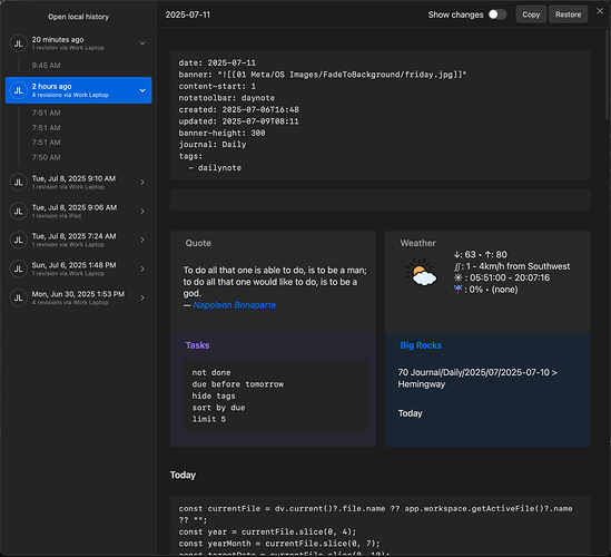

I was editing a meeting note, and I clicked on the Calendar to open my Daily Note (Periodic Notes plugin). The entire contents of the daily note was replaced with the contents of the meeting note. My daily note completely disappeared. Now when I open the file called “2025-07-11.md”, I see the contents of the meeting note from an entirely different folder.
Unfortunately, these notes have lots of confidential info, so I can’t share them - but screenshots included - Day note was revised at 7:51AM, and when I re-opened it at 9:45AM, it had completely different content.

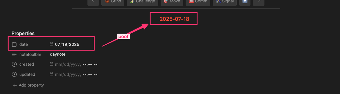

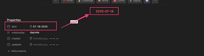

It just happened again. I was going through the week creating my Daily Notes by clicking on the days in the Calendar (via Periodic Notes templates…) All files created as expected, Templater bits expanded as expected, etc.
Then, as I was navigating “back” through the created notes, the entire contents of “2025-07-19.md” replaced the contents of “2025-07-18.md” as I was looking at it. The console shows that the note for the 18th “failed to create”, because it already existed. But all the text is from the note from the 19th.
I don’t know if this is a bug in Periodic Notes (I don’t think so, because I had the same issues with the Journals calendar as well…), Sync, or Obsidian itself, but it’s so frustrating.

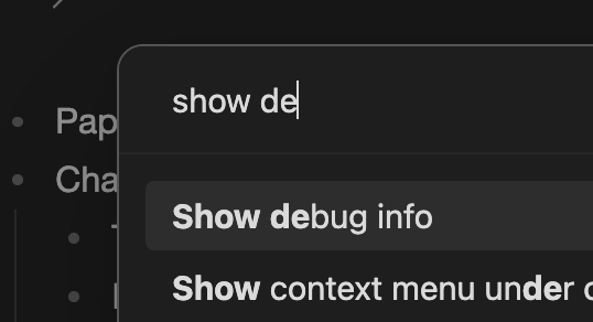

It’s not a log. It’s a command to show the configuration of your vault.
You can use Cmd-P for the command palette, type “Show debug info” and paste the results here. Or from the Help menu.
