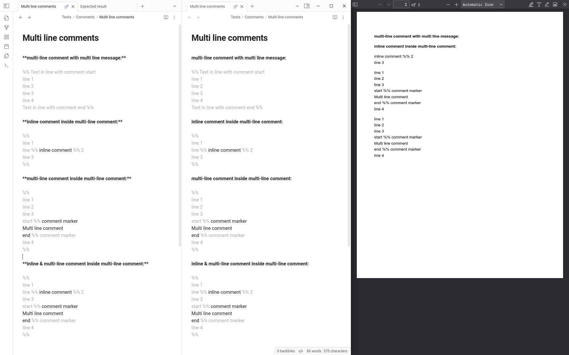

The begging and ending comment markers %% get bungled and non comment text gets removed while commented text gets displayed.
Reading view displays:
multi-line comment with multi line message:
inline comment inside multi-line comment:
inline comment %% 2
line 3
line 1
line 2
line 3
start %% comment marker
Multi line comment
end %% comment marker
line 4
line 1
line 2
line 3
Multi line comment
line 4
This is also the case for PDF exports as seen below:
