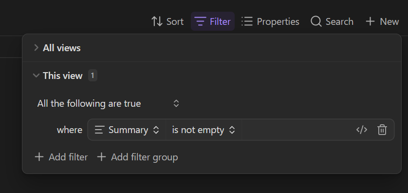

  2. Near the top right of the base, click “Filter” and enter “where Summary is not empty”, in this manner:
    (Replace Summary with the name of your summary property, if it has some other name.)

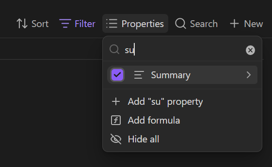

  3. Click “Properties”, and select “Summary” (or whatever yours is called):
See how it looks.

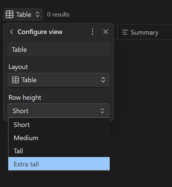

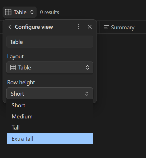

To have taller rows:
  1. Click “Table” at the top left of the base then click the arrow next to the popped-up option named “Table”:
  2. Expand “Row height” and select a height of you choice:
See what you think.
