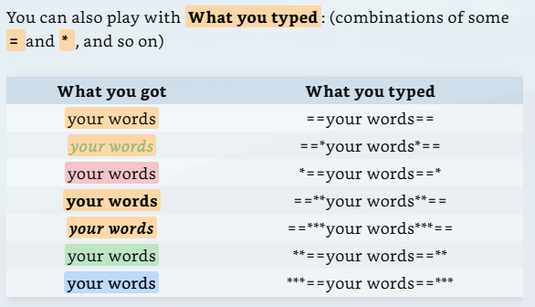

If you wanted to hijack **bold**, _italic_, ***bold italic***, ==highlights==, %%comments%%, combinations of those, and maybe one or two more built-in options, you could easily (more or less) do that with CSS alone. However, CSS can’t target arbitrary text (e.g., make all instances of {fish} a salmon color). For that, you need a plugin as well.
One example of coloring and highlighting by combining = and *, using CSS only, is from the https://github.com/PKM-er/Blue-Topaz_Obsidian-css theme:
