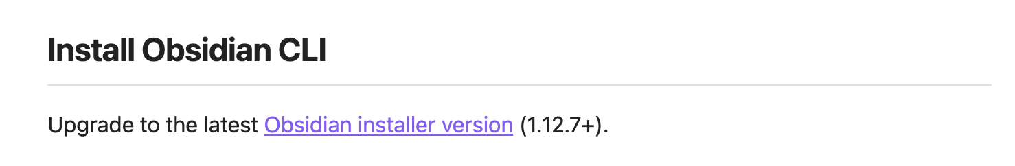

Don’t know if this will help with your issue, but update your installer to the latest one.
https://obsidian.md/help/cli#Install+Obsidian+CLI
