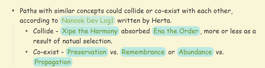

Here is the piece of css i made for the above effect:
.markdown-rendered .internal-link,
.cm-s-obsidian span.cm-hmd-internal-link {
  background-color: #00c3ff40;
  border-radius: 10px;
  padding: 0 0.25em 0.1em;
  text-decoration: none; /* if you have the underline effect and want to remove it*/
That’s exactly what I need. The long lines won’t be a problem if the names are highlighted nicely. They are only a problem when the only visual indicator of when one name ends and the next begins is a space vs a space with a tiny underline.
Wonderful! Thank you. It went from this ugly thing:
To this pretty thing:
I’m wondering, isn’t it confusing if internal embeds and people share the same highlight ?
