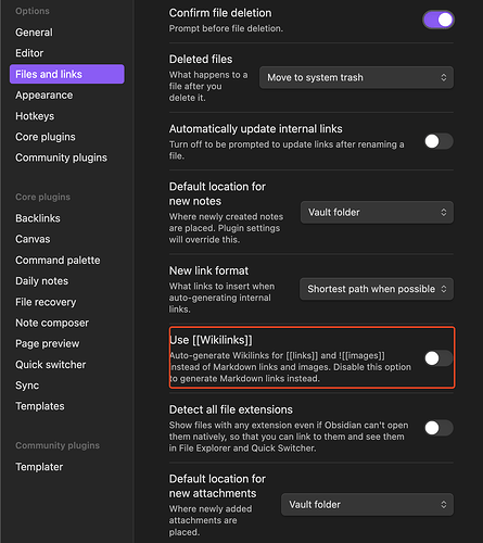

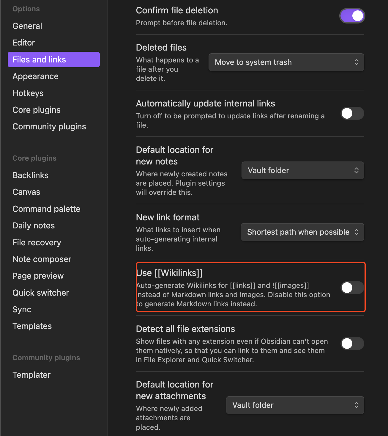

I came up with some other solution not featuring any plugins:
  1. Disable wikilinks:
  2. Drag and drop your file to Files (left side bar)
  3. Go to your active note and write [[ and select your file either using down arrow ↓ and enter or left click
