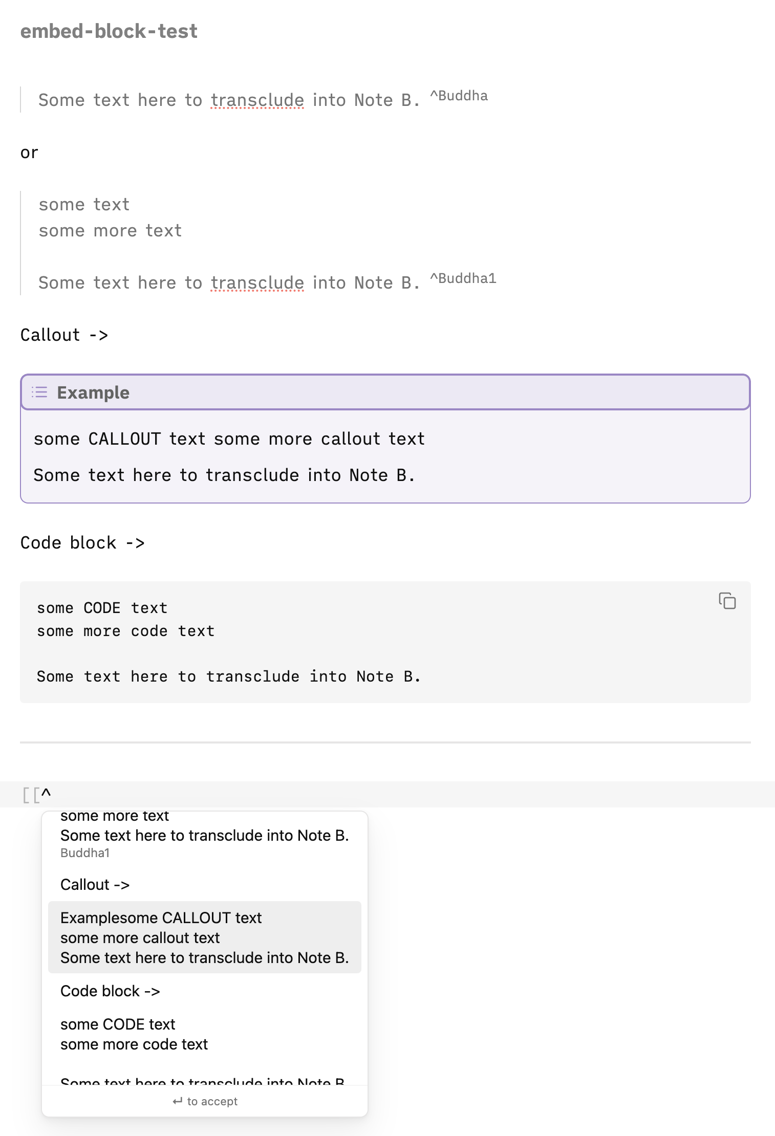

Does your block quote look like
> Some text here to transclude into Note B. ^Buddha
or
> some text
> some more text

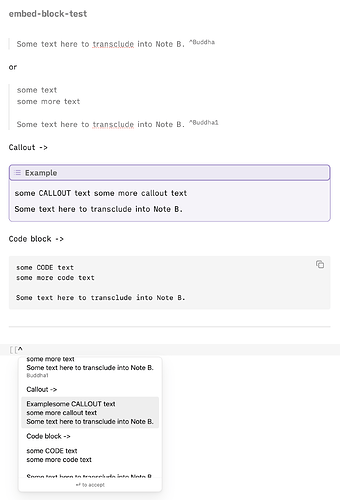

If you use the auto-suggester [[^, you can scroll through what Obsidian considers a block.
As far as I know anything within block quotes, callouts, and code blocks – even if multiple lines – is considered one block.
