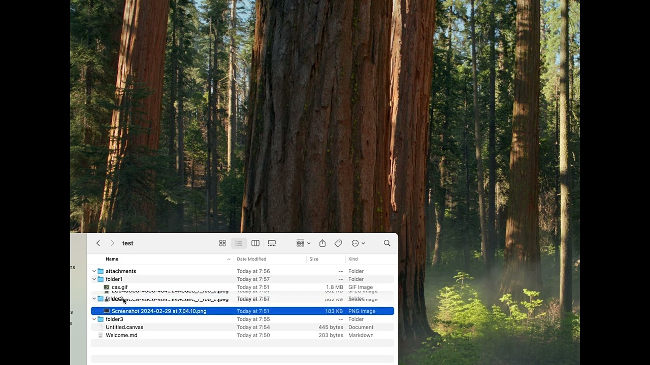

Some discussion on Discord earlier. It wasn’t clear if the vault was open or not during the (outside Obsidian) Windows File Explorer move of the image.
In a quick test on macOS, I moved the image file using Finder. If the vault is open, the image in a Canvas is fine. If the vault is closed, the embed is missing when reopening the vault. This seems expected to me.

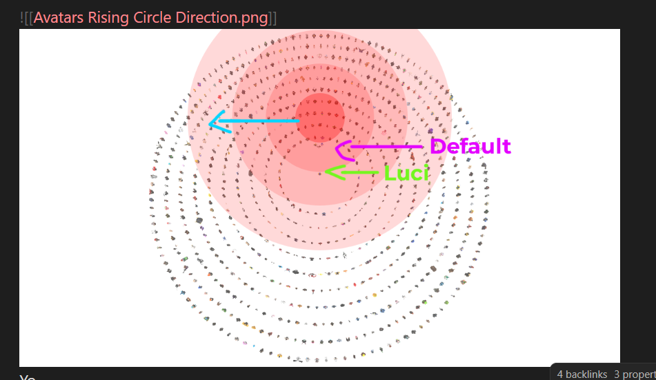

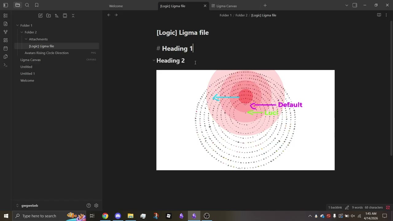

My bad for the confusion. Canvas will ignore my File and Link Settings when New Link Format is set to Shortest Path When Possible. All my images and files contain unique names, so when I go and place an image in a file, or go and reference the image within the file, the link will be ![[Pasted Image 12421421512512]]. But if the same image is linked in the Canvas, regardless of the settings, it will be ![[vault/folder/Pasted Image 12421421512512]].
The reason I wrote about it, is because I like to organize my files, especially images, into specific folders, and when you have a large vault, its a 1000x easier and faster just to do it through the Window’s File Explorer. Again, this is usually fine for me, as all my images have unique names such as ![[Pasted Image 12421421512512]], so It doesn’t matter where the image is located in the vault. But in Canvas, since it forces a path for the image, if I move images around using the Window’s File Explorer, it will see that it is not down the specific path, and will request new image location.
Image in file after being moved:
Image in Canvas after being moved:

I can get the “XYZ could not be found” card if moving the image outside of Obsidian with the vault closed and closing-opening the .canvas.
