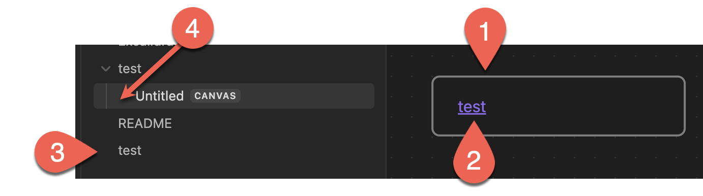

  1. Canvas having a Card
  2. A link to a non-existing note
  3. Clicking on the link actually creates the file at the root of the vault
  4. Notice that the Canvas is actually inside a folder called “test”
As mentioned above, this new note should have been created next to the Canvas.
