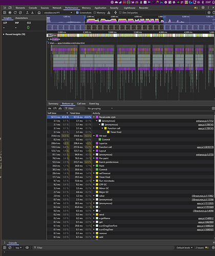

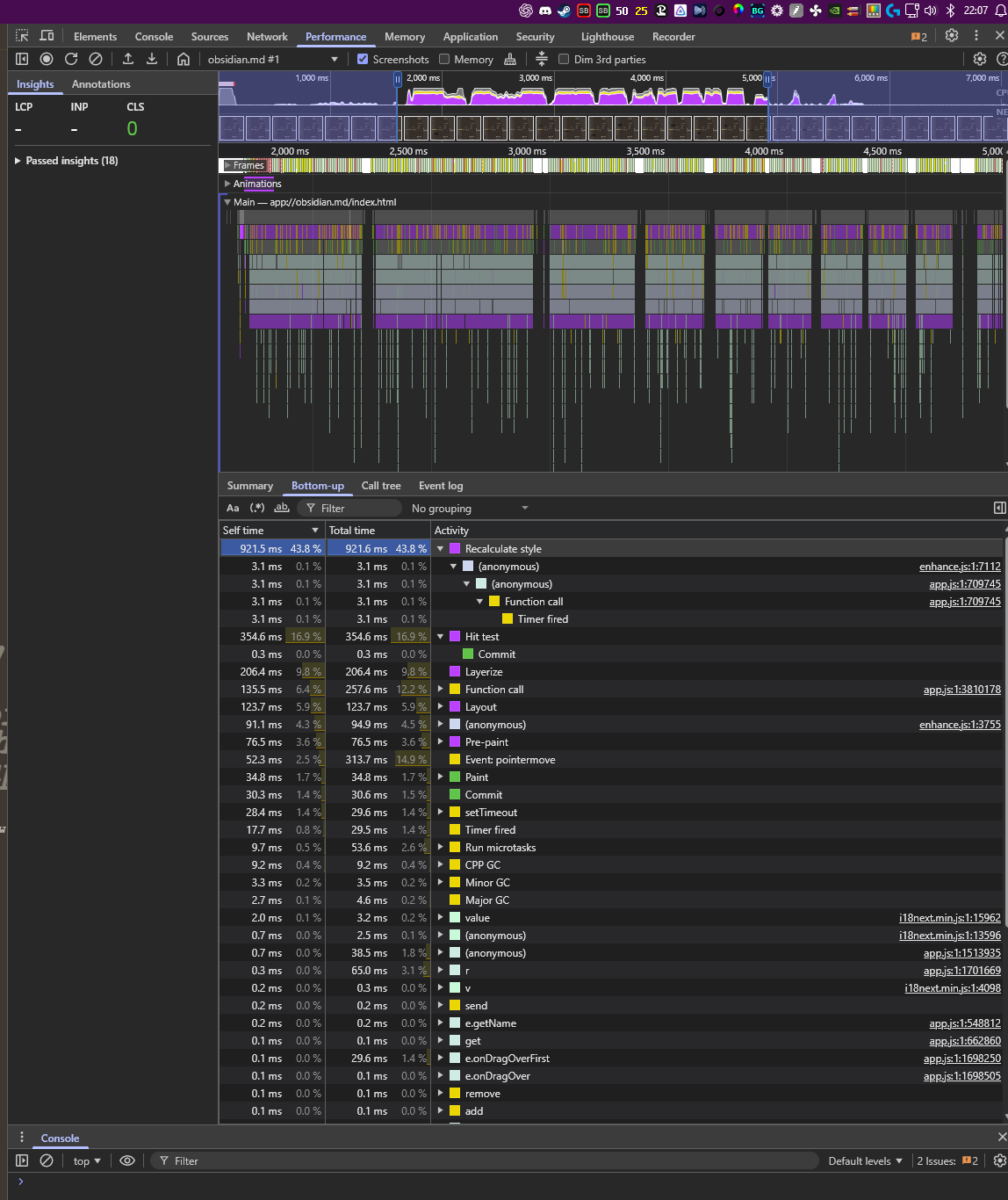

1.12.7, restricted mode, only theme enabled as I’m working on it, no snippets enabled.
1.13.7, same test as before.
The Ukiyo theme known to have the drag&drop lag, as I was debugging the lag, it’s happening too with the default Obsidian theme, I can’t add links here, if you search “Ukiyo theme lag when dragging files” you can find it.
