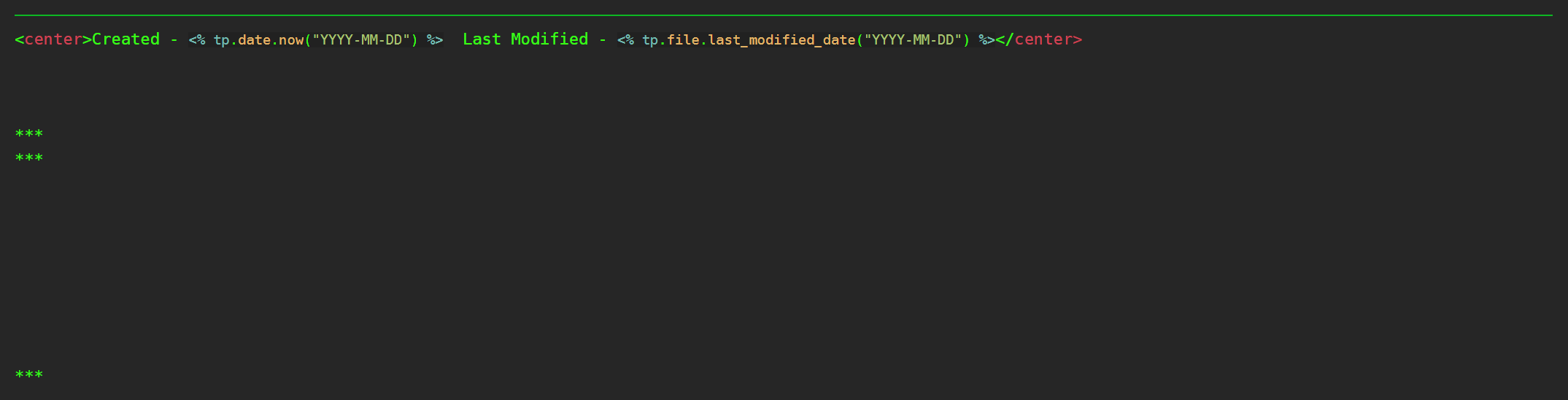

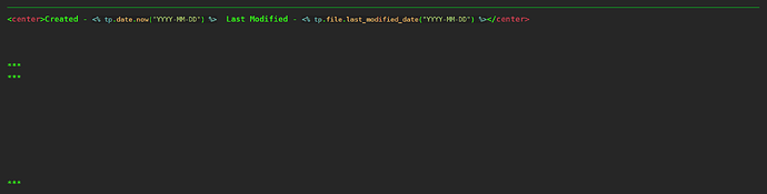

I am trying to place a horizontal rule using *** on the line directly under a templater code snippet:
<center>Created - <% tp.date.now("YYYY-MM-DD") %>  Last Modified - <% tp.file.last_modified_date("YYYY-MM-DD") %></center>
For some reason the horizontal rule will not render if placed below this code. This is the case even if I try to insert the rule well below the code.
I can place a horizontal rule above this snippet no issue, below will not work for me.
This is probably operator error as I am into this prog for an hour or so, but I cant seem to figure it out.
Make sense?
Thanks!
Here is the solution.
Change the above code to this, and horizontal rules will render below it.
<% "\<center>" %>Created - <% tp.date.now("YYYY-MM-DD") %> Last Modified - <% tp.file.last_modified_date("YYYY-MM-DD") %><% "</center>" %>
