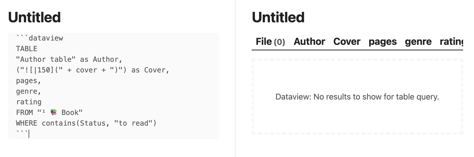

What error do you get with this:
```dataview
TABLE
"Author table" as Author,
("![|150](" + cover + ")") as Cover,
pages,
genre,
rating
FROM "¹ 📚 Book"
WHERE contains(Status, "to read")
Locally, the query parses but returns no records as it has no data to harvest. Does it work for you or do you get a specific error message?
Can you give a YAML sample?
What is the first character in the FROM folder name?
yes, I have like on the last photo you sent
the first character is “¹”
