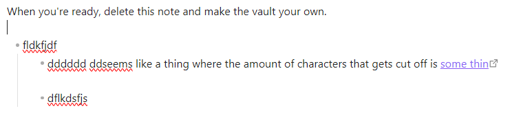

Bullet with external link has extra line on wrap
I do not have an extra line; it appears that the “external link” character causes the line to “wrap” but also does not wrap, causing an extra line space.
New vault, add the following text to the default note. (Take it out of the code block.)
Or, simply make an external link (that has the “arrow” icon) and make it on 2nd level bullets, so that it pushes to just off the end of the line (before it wraps).
When you're ready, delete this note and make the vault your own.
- fldkfjdf
	- dddddd ddseems like a thing where the amount of characters that gets cut off is [some thin](https://www.hi.com)
	- dflkdsfjs
Yes
Expect to see no wrapping because the characters shouldn’t wrap. Or, if wrapping, I expect the characters to appear on the next line.
Extra space.
