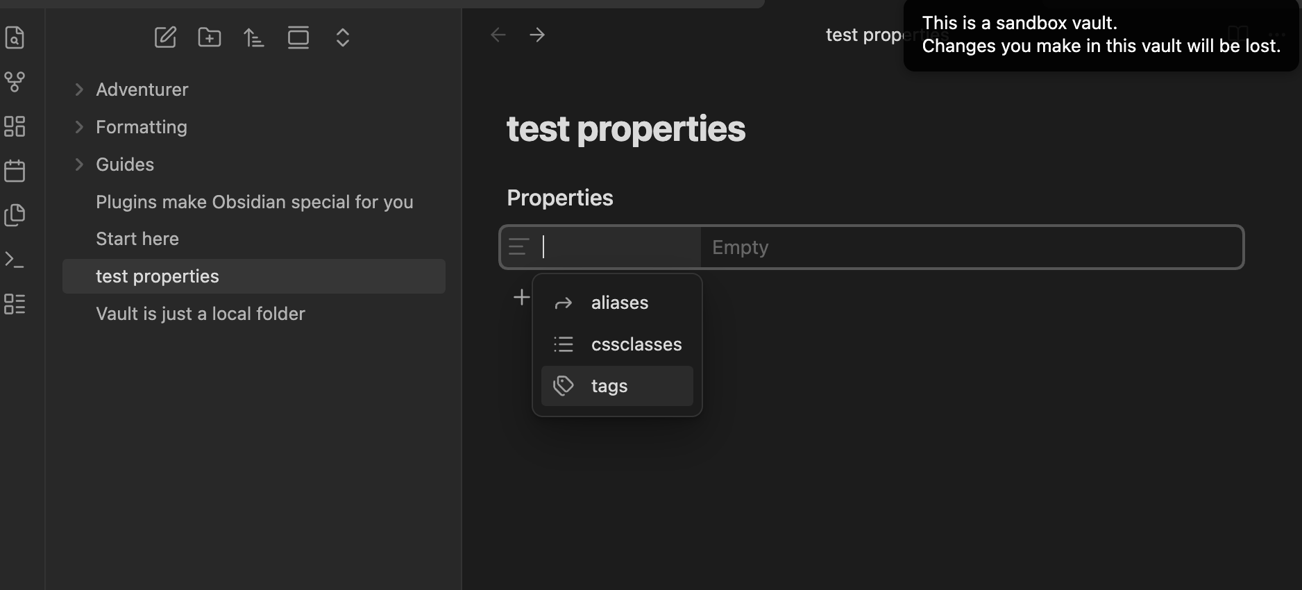

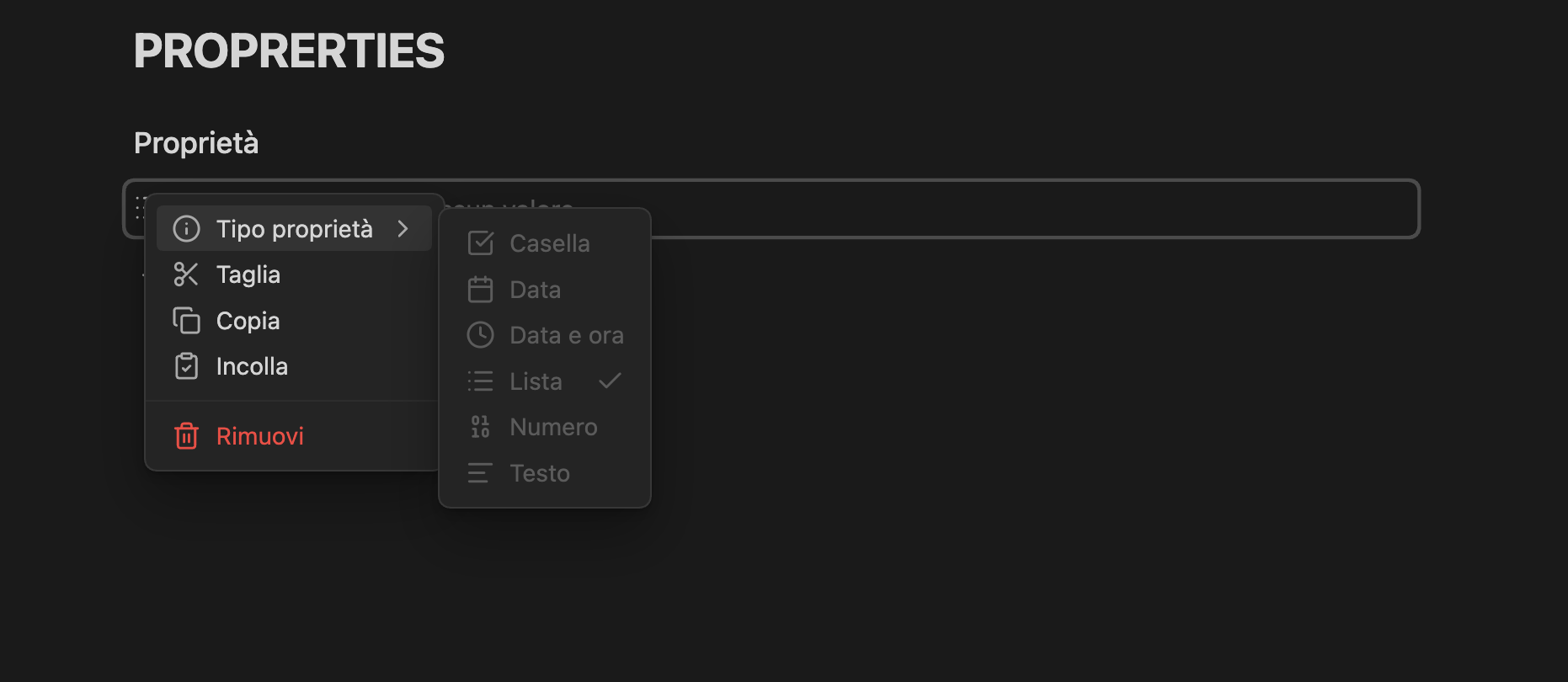

I’m Alberto. I Use ObsidianVersion 1.13.7 (Installer 1.13.7) and I tryed also on sandbox vault. I get a problem with properties. I apologize for my English. Here’s the translation:
“When I click on the three bars to set/format the property on a note, I can’t select either the date or the text or any other function. Please check my screenshot.” Thank you in advance for your possibile help.

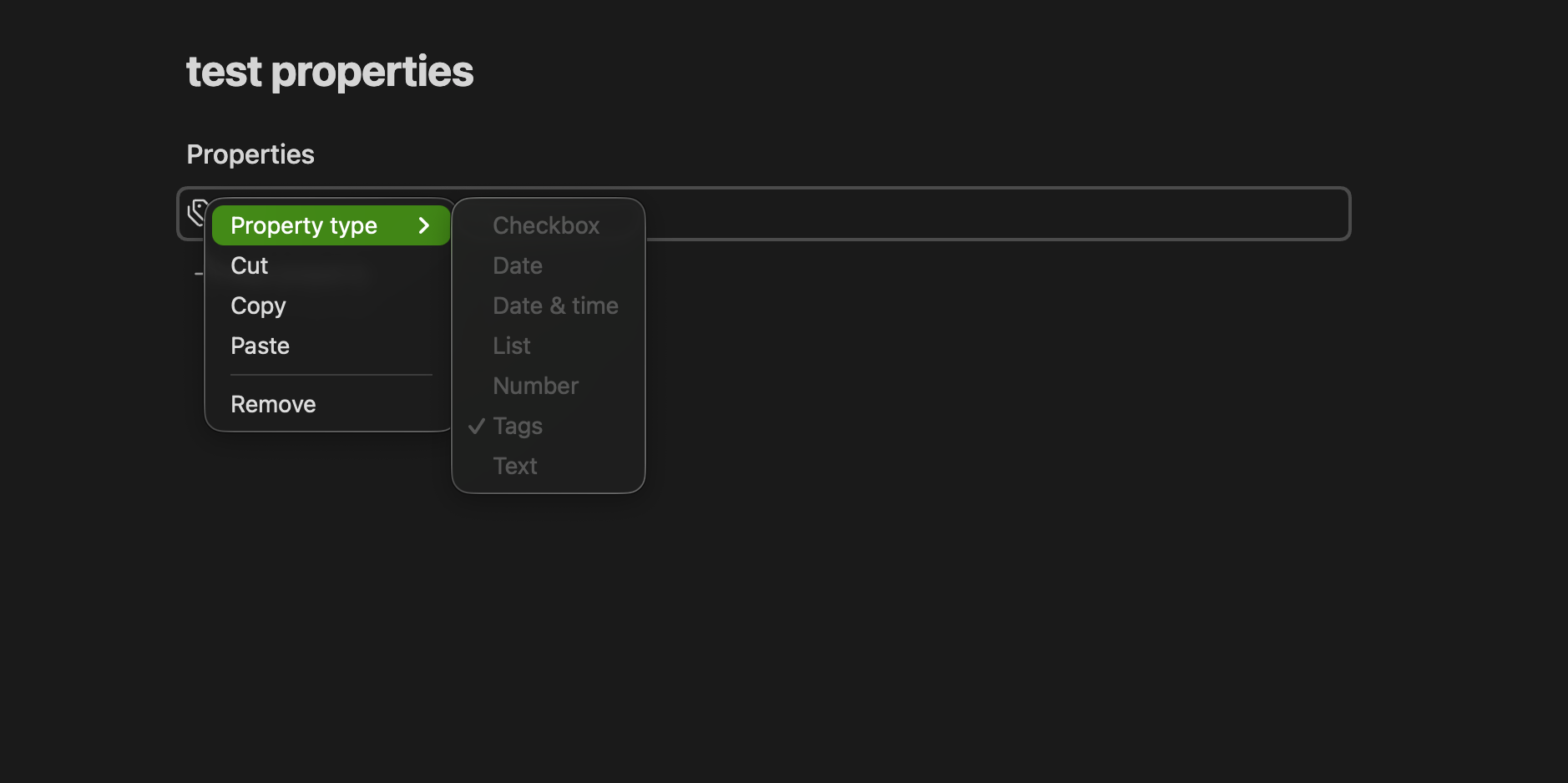

Yes please see below
“Thanks for the information, but the problem is that I can’t see the list — only the entries you see in the last screenshot.”
"The dropdown menu is unclear/unresponsive and won’t let me select anything and I don’t know why

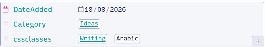

I was trying to see something like this:
if the fields are empty I don’t think you’ll be able to change the type.

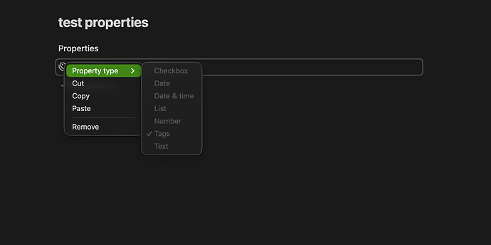

But the fields is not empty. I’ve tried both the `tag` function and `cssclasses`, and in both cases the drop-down menu is grayed out and cannot be selected. I also tried adding a reference tag anyway, but the result is always the same.
tags and cssclasses are bultin properties of type list, you cannot change them.
