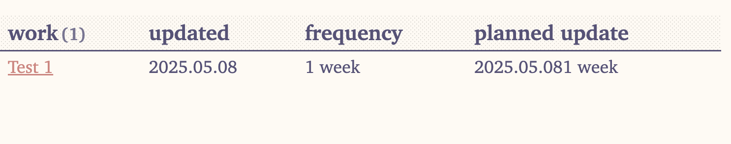

Thanks for the help! I tried your second table and it is almost there, the only part that went awry is the:
updated + frequency AS "planned update"
I tried it with a test note and it was displayed as 2025.05.081week instead of 2025.05.15. I typed the frequency as 7 days and somehow it got auto-converted to 1 week. I think maybe using sum might help.

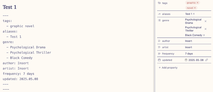

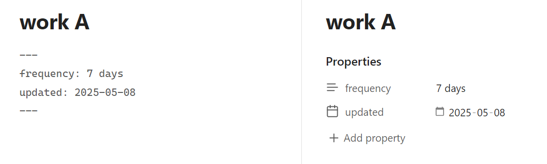

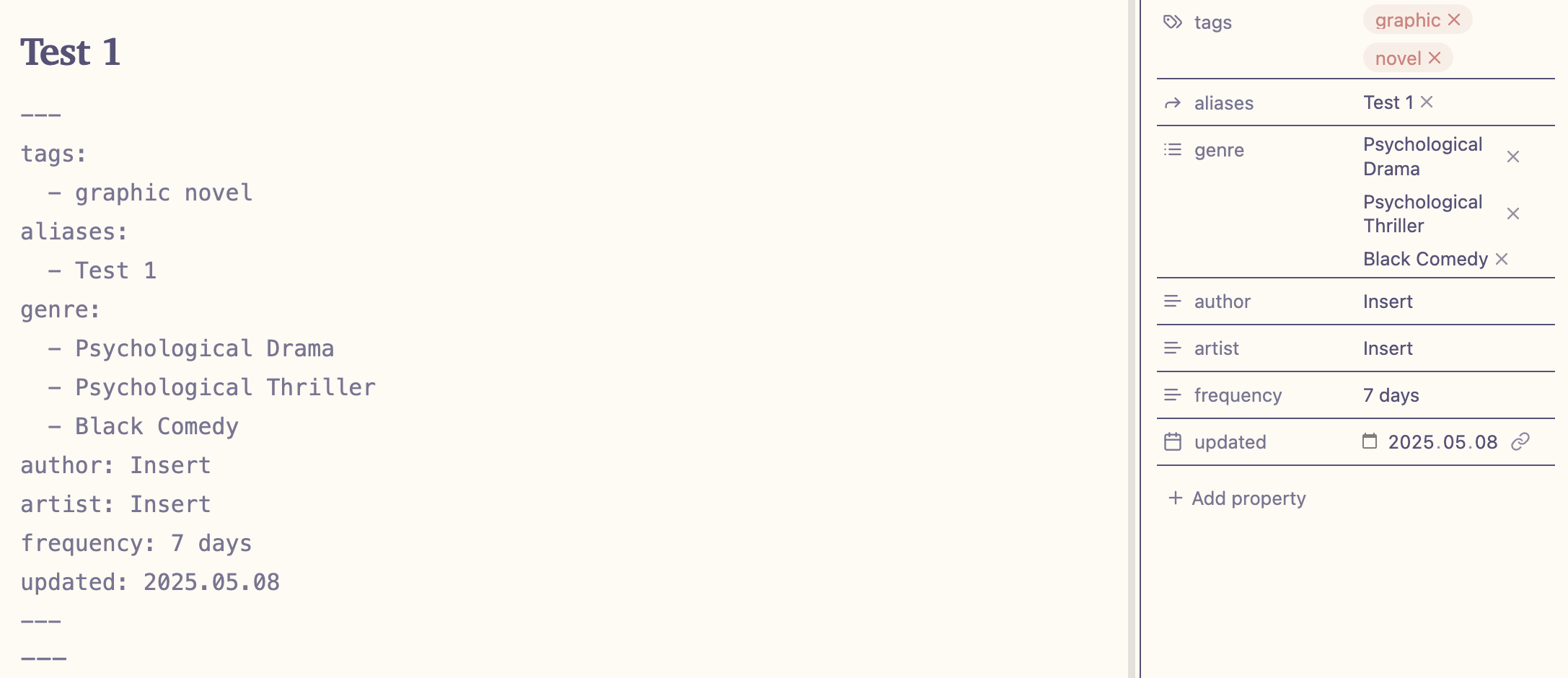

How are you listing your frequency in your note? Is it in the frontmatter like this:
…or something else?
Yup, I’m listing it in the frontmatter like that.
I cannot in any variation replicate your result with the “1 week” appended. Here’s what I get:
