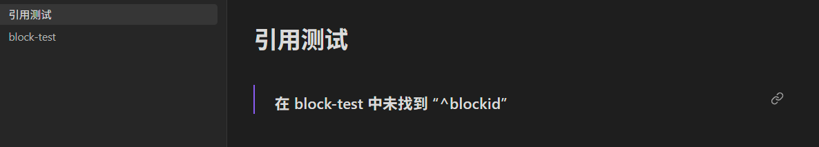

Steps to Reproduce:
  1. Create a new vault at C:\TestVault

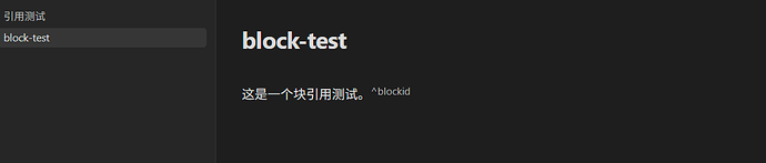

  2. Create a note called block-test.md with the content:
    This is a block reference test. ^blockid

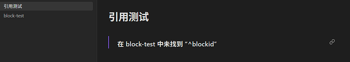

  3. Create another note called block-ref-test.md with the content:
    ![[block-test#^blockid]]

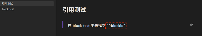

  4. Observe: The embed displays “Could not find block reference ^blockid in block-test”
    (see attached screenshot)

Does it work if you remove the quote marks?
Quotes are shown if the block reference isn’t found:

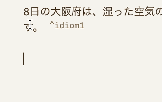

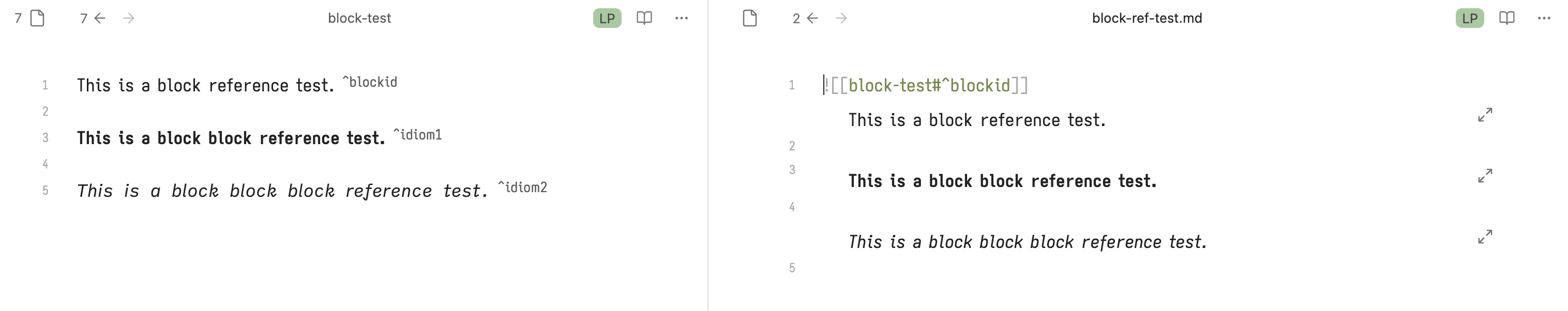

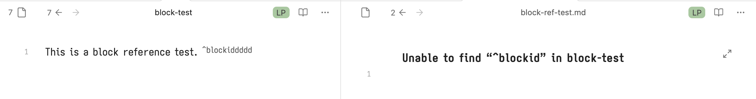

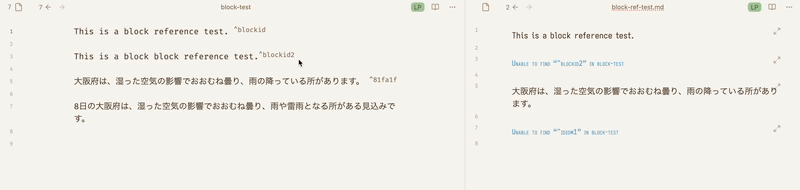

For me, the first one below works, but the second doesn’t. The only difference is having a space in the first one between the and the ^:
这是一个块引用测试。 ^blockid1
这是一个块引用测试。^blockid2

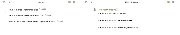

So just a syntax issue? It needs a space to work?
Good catch Guapa!
It may well be do to the spacing. It’s clear when using English alphabets there isn’t a space between the text and block ID, but not so much with Japanese and I assume all CJK character sets because of the double-width they take up.
CleanShot 2025-07-08 at 05.11.48
CleanShot 2025-07-08 at 05.25.04
Having Obsidian create the block ID (eg ^81fa1f) correctly adds the needed space, but when adding them in yourself you need to be careful.
