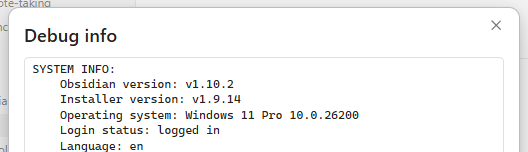

If you are running an old(er) Installer version, I’d download and reinstall Obsidian. The latest, Obsidian-1.9.14.dmg for macOS, can be downloaded from https://obsidian.md.
Obsidian version: v1.9.14
Installer version: v1.7.7
Operating system: Darwin Kernel Version 25.0.0: Wed Sep 17 21:38:03 PDT 2025; root:xnu-12377.1.9~141/RELEASE_ARM64_T8112 25.0.0
Plugins installed: 0
Plugins enabled: 0
I haven’t updated my Macs to Tahoe yet, but Darwin Kernel Version 25.0.0 = macOS Tahoe which is causing issues with apps using older electron versions (not only Obsidian).
I’d update the installer if you haven’t yet and see how that goes.
The installer has been updated to use Electron v37.6.0 (requires downloading the latest installer). For users on macOS Tahoe, this may improve app performance.
