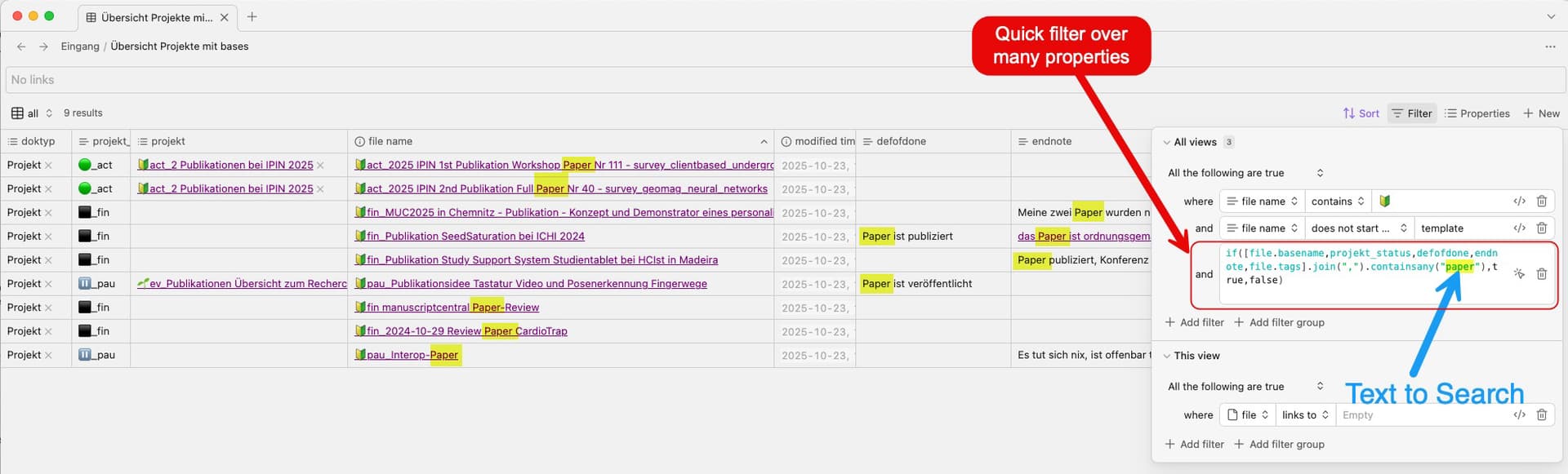

Screenshot of my filter:
(In the screenshot, I highlighted the search term for better visualization — in reality, it won’t be highlighted inside the actual filter.)

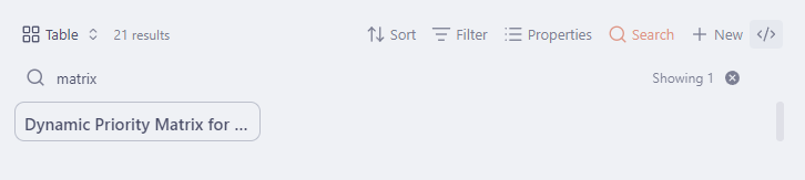

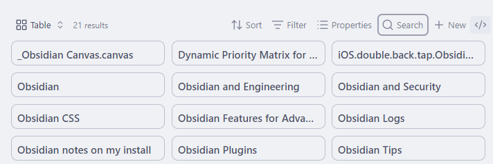

Obsidian desktop 1.12.1
note the search icon.
the search filename filters the .base
super fast.
