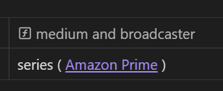

Preferably the outcome would be for example: series (Amazon Prime). Where “Amazon Prime” would be clickable as a link.

Do you mind if there’s a little bit of space inside the parentheses?
That method makes a list of your two lists then displays them all inline, to preserve links:
[medium, "(", broadcaster.map(value), ")"].flat()

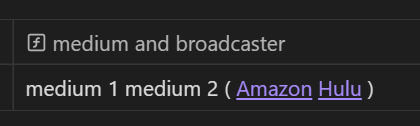

It’s designed for your example YAML of two lists with one value each. I didn’t know what you would want to display when you have multiple values, like:
If you want that to look differently, can you describe?
