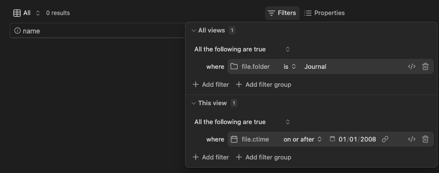

  1. Create a new bases table.
  2. Add a filter for the view "file.ctime > “2008-01-01”
Yes
The table should list all the notes with the created date after 2008-01-01
No results are shown the table

With the date filter, I get no results:

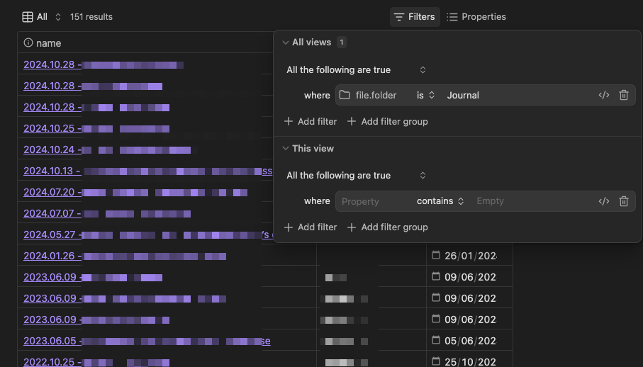

Remove the date filter, and the notes show up:
