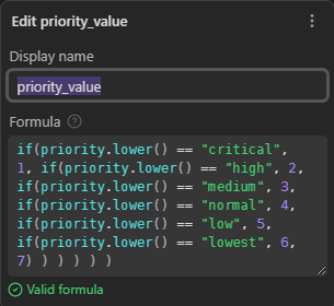

In bases the formulas seems to be case sensitive. I have a formula that converts the text to a value that I can then sort from:
However, the property in the base column seems to only call/effect the capitalised Priority even when it is typed in lower case:
What is the best approach here to organise this mess and unify to a single priority property??

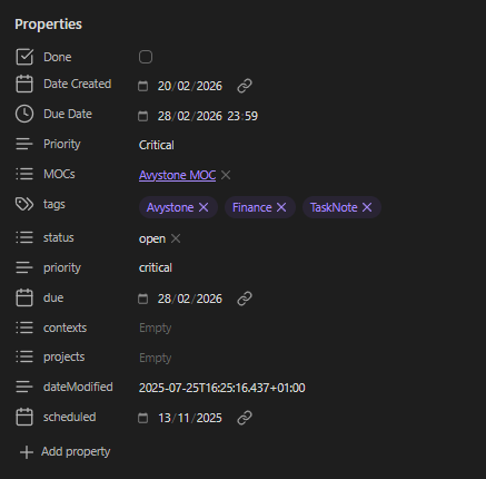

thanks for the reply. here is an example.
you can see I have priority property twice. It is because I used to do it manually through data view (where I used “Priority”), I now use TaskNotes plugin that uses “priority”. my goal now is to merge everything into the lower case priority. I should have just adjusted the field mapping on task notes, but its too late now as too many notes are like this, I just have to commit. :joy:
