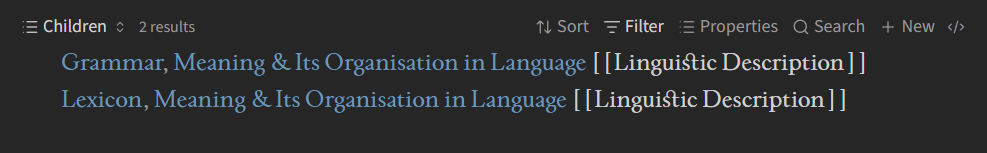

This is how these two notes are displayed from the Linguistic Description note (this is the correct, expected output):

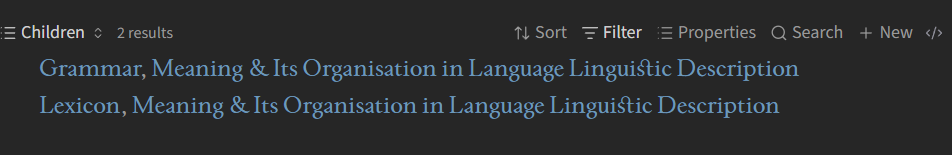

However. this is how those same two notes are displayed by the same embedded base from the other parent note (here, the second link has been converted to a string):

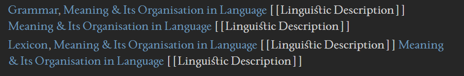

From this same parent note, using list concatenation (themes + themes) also converts the Linguistic Description link to a string, whereas the same works in the other parent note:

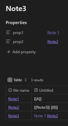

Observed Result
Expected Result
The rows for Note1 and Note2 should contain actual links to the notes A and B, not strings. Essentially, those rows should behave just like Note3’s row, which successfully links to Note1 and Note2.
Notes
  • This isn’t exactly the behavior of OP (where the first list DOES retain its links). I have experienced that specific issue in my main vault, but couldn’t repro it in the Sandbox Vault.
  • Linking behavior looks normal in the properties of the respective notes, only the base is incorrect.
  • Behavior does not change depending on whether notes have been created. In the example below, I’ve
    1. invalidated Note3’s link to Note1 by adding a whitespace to the filename
    2. changed Note2’s link to “A” to have it link to Note3 (which is currently open and therefore exists).
