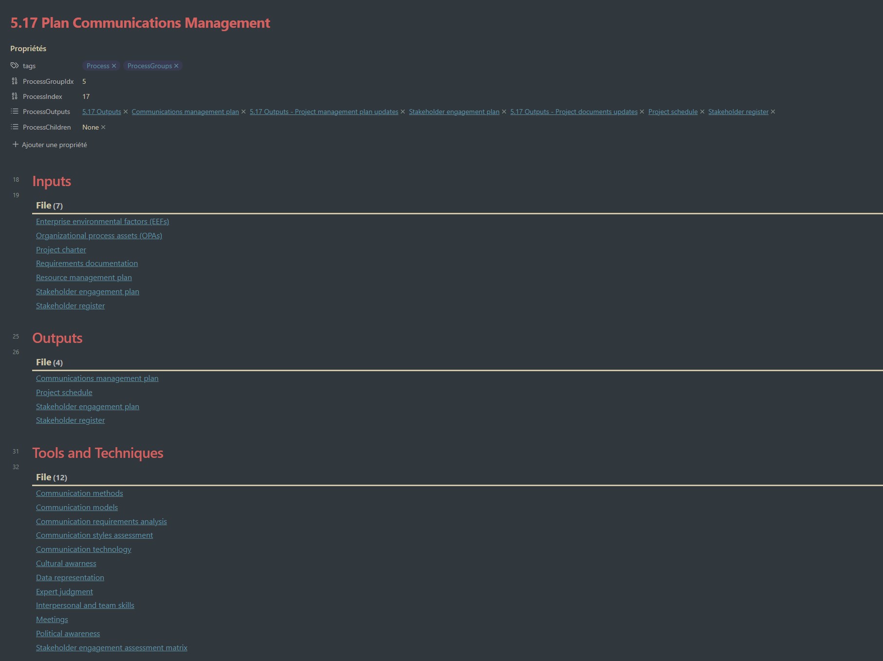

The one thing I miss and I cannot produce by myself, is a more condensed way of presenting the whole Inputs and Ouputs thing for a single process. Right above, I used the following codes to get the lists in the image :
# Inputs
``dataview
TABLE
FROM #InputsAndOutputs
WHERE contains(file.outlinks,this.file.link)
SORT file.name ASC
# Outputs
``dataview
TABLE
FROM #InputsAndOutputs AND outgoing([[5.17 Plan Communications Management]])
SORT file.name ASC
# Tools and Techniques
``dataview
TABLE
FROM #ToolsAndTechniques
SORT file.name ASC
By doing this, I have the list of all Inputs and all Outputs, but on two different lists. I would really like to have them in the same list, as well as with additional data on them, like this :
Asset Belongs to Input subgroup ? Input ? Output ? Belongs to Output subgroup ?
Stakeholder register 5.17 Inputs - Project documents Input Ouput 5.17 Outputs - Project documents updates
Stakeholder engagement plan 5.17 Inputs - Project management plan Input 5.17 Outputs - Project management plan updates
Resource management plan 5.17 Inputs - Project management plan Input
Requirements documentation 5.17 Inputs - Project documents Input
Project schedule Ouput 5.17 Outputs - Project documents updates
Project charter Input
Organizational process assets Input
Enterprise environmental factors Input
Communications management plan Ouput
The fact that an Asset is part of a subgroup is supported by explicit link between the Asset Note and the Subgroup Note (from the Subgroup to the Asset).
The fact that an Asset is an Input for a specific Process is supported by a link from the Asset Note to the Process Note. And the same thing for a SubGroup of Assets as Inputs to a Process.
The fact that an Asset is an Ouput for a specific Process is supported by a link from the Process Note to the Asset Note. And the same thing for a given Process to all SubGroups of Assets as Outputs.
The intent here is to clarify which Assets are only consumed in the Process, which Assets are only created be the process, and which ones are altered (used as Inputs and as Outputs by the Process)
